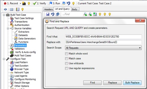

You can’t change the .saz file because it may have a checksum which will not verify if the file is changed, so that is why you are getting the errors.
You need to create a parameter and do a bulk replace and replace WEB_DC00BFB5-8DCC-4AA9-B644-6D3C612E2780 with {{QAPerfstressUsers.InterchangeSerial$VUBound}}
Open the Find and Replace dialog in Parameterization Editor (Ctrl+F) and set the search Scope to All Requests.
