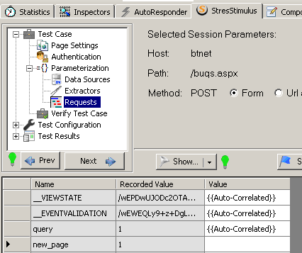

If the _RequestVerificationToken is a hidden field in Post messages that should be carried over from every response to the subsequent request, then it should be handled by StresStimulus similarly to how it works for _VIEWSTATE field, using the built-in automatic autocorrelation.  In this case, if you select the Post request in the Fiddler grid, then the Parameterization grid in the Test Case -> Parameterization -> Requests section should show {{Auto-Correlated}} as shown below.

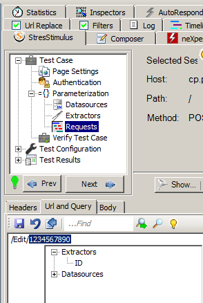

On your second question: if you wish to use the extractor to parameterize a URL (in opposed to a Header or Body), then click the Requests node and select the "URL and Query" tab ( in opposed to the Headers or Body tab). if your URL does not have a query string, (e.g RESTfull URL), StresStimulus will display the parameterization editor, as shown on the screenshot below. Simply select the recorded value, right-click, and select your extractor that you wish to use to parameterize the value. You are done.

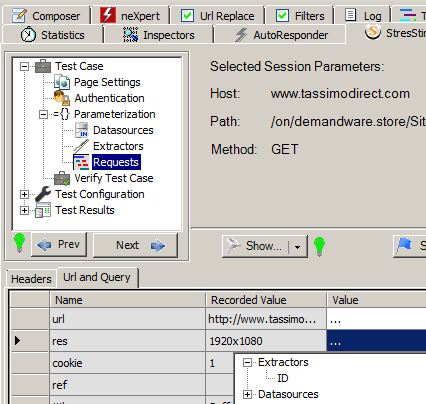

If, on the other hand, your URL has a query string, then, instead of displaying the parameterization editor, StresStimulus will display the parameterization grid, as shown on the second screenshot. Right-click in the Value column of the required parameter and select your extractor.
