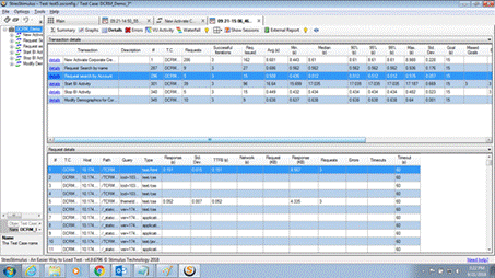

I need to calculate -> Elapsed Time(Avg resp.+think time)
From the below format, How shall I calculate it ?
I am getting the avg. response time from the below table.
Please help. Will then evaluate the rest.

StresStimulus excludes the think times from the elapsed time because the latter depends on how the script was recorded or configured, while the response time depends mainly on the system performance that most users are interested.
However, you can find out the Elapsed Time of a given transaction during a given iteration by opening the waterfall diagram.
  • Open the transaction result tab http://support.stresstimulus.com/display/doc50/Page+and+Transaction+Result+Tabs
  • Click on the Waterfall button to bring up waterfall chart http://support.stresstimulus.com/display/doc50/Waterfall+View
  • Input the desired VU and iteration to bring up the waterfall chart of that transaction for that VU and iteration.
  • The Elapsed Time is the time from the beginning to the and of the transaction as shown on the graph timeline.
