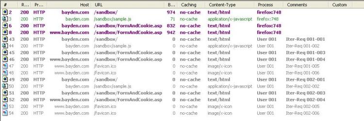

Hi Vadim,
 Based on the discussion "_VIEWSTATE values and parametrization", I used the www.bayden.com/sandbox  to check the correlation in stresStimulus.
 After running the test, it shows "0 bytes" in response Body column. In Inspectors webview shows "Response cannot be rendered". It seems like the request was not getting the successful response but the test result doesn't show any failure.
 Below is the screenshot shows the recorded and executed sessions.The load settings are
 VU = 1 & No. of Iterations = 2.
If i am missing anything, please guide me.
Thanks
-Seenivasan
3/30/2011
Hi Seenivasan,
By default, StresStimulus removes response bodies from the load test sessions to save memory on large tests. To see the full response, go to “StresStimulus Options” and uncheck “Purge test sessions’ response body”. We will update Help boxes to make it more clear.
