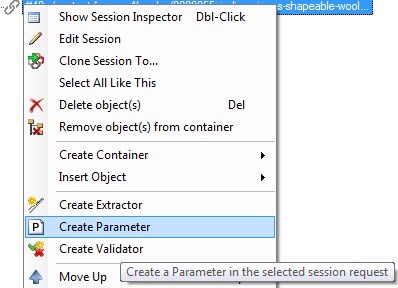

When the number of autocorrelation values exceeds a certain number (a few thousand), they are not displayed in the test case tree. This is done to improve the performance of the tool as too many elements in a tree will slow down the UI.
To confirm the autocorrelation parameters are there, right-click on a request and select Create Parameter. The dialog box will show all the autocorrelations for that request.
