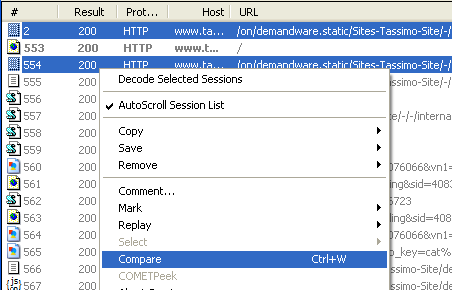

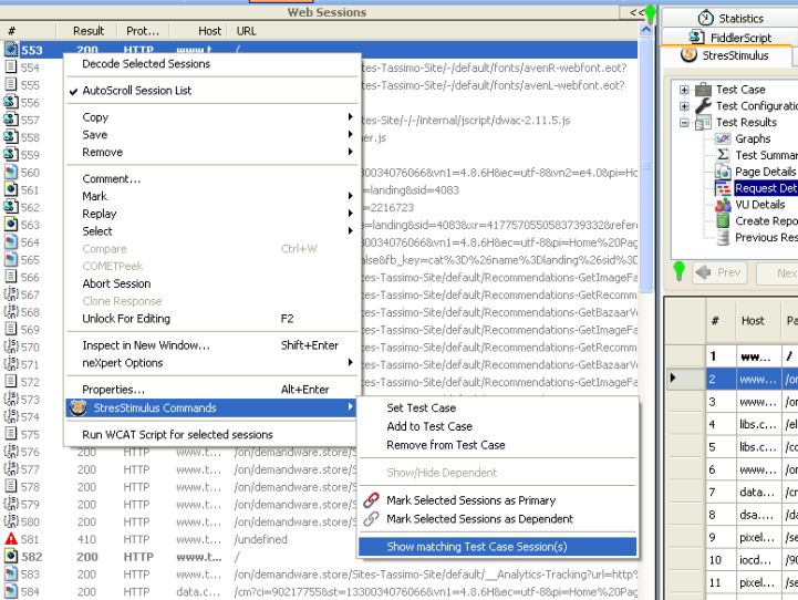

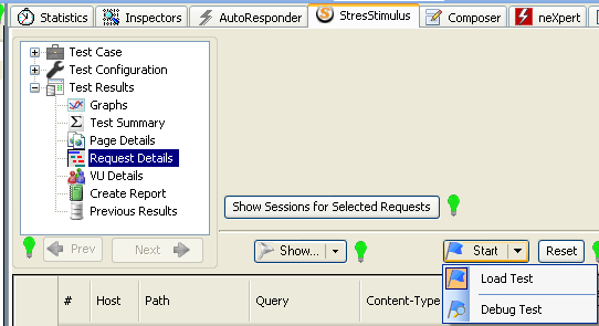

As in any speculation, this may not be what actually happened. But thanks to Fiddler and StresStimulus transparency, you can troubleshoot and find out exactly what happened by comparing recorded and replayed requests and responses. To do so:
1. Run the test in debug mode with 1 VU. The replayed sessions will appear in the Fiddler grid.
2.Display the matching recorded sessions.
 3. Compare the in with windiff
 This exercise should give you a pretty complete picture of what has happened.
