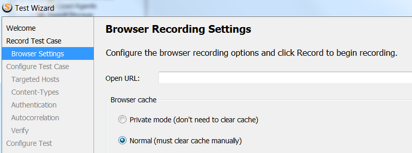

The recording browser is getting open in private mode (IE) or Incognito(Chrome). However during recording in IE I am getting some application errors. In Chrome I'm getting even more errors. My application works in IE and Chrome. Why am I getting errors in the recorder?
2/27/2017
During recording, browser cache should not be used, so all requests are captured. Recording in private mode is the default setting because the browser is forced to ignore its cache and therefore you do not need to clear it manually.
However, as you correctly noted, some applications do not work in private mode. In such situations, select the normal mode in the test Wizard, as shown below.
However, prior to that manual clear the cache in the browser that you record with.
Does this make sense?
