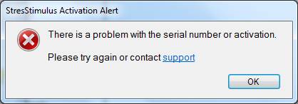

I am getting the below error while trying to activate the license.

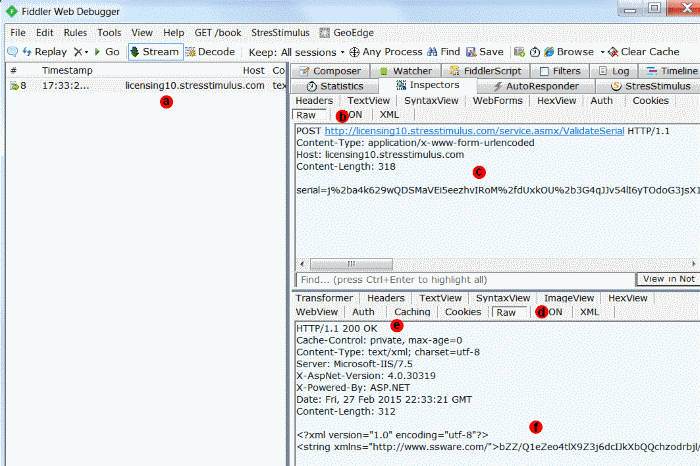

To troubleshoot network connection during StresStimulus activation, start Fiddler. When you activate StresStimulus, Fiddler should capture a request to the licensing host http://licensing10.stresstimulus.com (a).
In the request Raw inspector (b), the POST request should be sent to http://licensing10.stresstimulus.com/service.asmx/ValidateSerial and the field “serial” shall not be removed (c).
In the response Raw inspector (d), the status coach should be 200 OK and the license string (f) should be present.
If any of these conditions break, then the firewall blocks the request. To resolve this issue, you need to get an unobstructed access to our licensing server http://licensing10.stresstimulus.com
