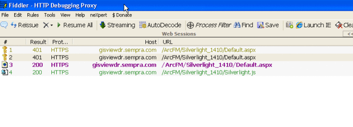

I'm getting a 401 response to all my requests during a test with StresStimulus.  I'm running under Windows in an active directory domain.   Does StresStimulus have any issues with authorization?

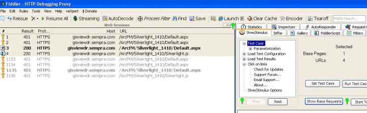

Thanks for the quick reponse.  IIS is version 6 and authentication is NTLM. The following are a few screen shots of what I am getting when I setup and try to run the test.
First screenshot - Fiddler Captured sessions
Second Screenshot - All 401s after "Run Test Case Once"

5/6/2011
Charles,
StresStimulus does not support NTLM as of now. Basic authentication should work.  I may be able to give you more updates on this topic as soon as next week.

8/17/2011
Hi Charles,
I wanted to let you know that support for NTLM authentication is added in the v1.0 Augusts Update released today.
Thanks for your thought!
