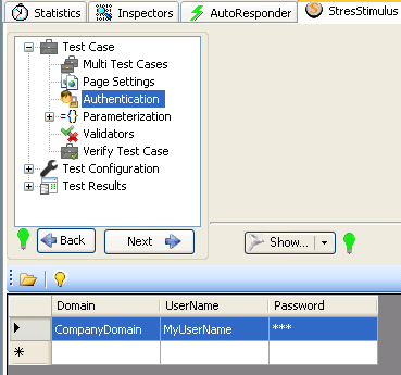

Do you receive the 401 during the recording or during the replay? If the recording works fine and the 401 comes up during the verification, then make sure to enter correct user credentials (domain, username and password) in the Authentication section, before running "Verify", as shown below.

Hi Vadim, Tx for your reply, I have added credentials, and can also see them in the request, but get the same error. Hopefully this afternoon someone from support will join me in a webex session, I will keep you posted of the results.

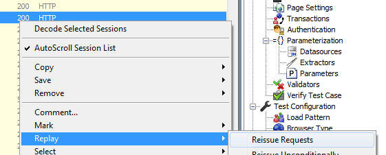

As you suggested in one of your messages, the issue was caused by the client (SAP BPC V10 client, Fiddler and StresStimulus) and the server being on the same machine. We determined that this is the case by re-issuing the login request from Fiddler and receiving the same 401 error. The screenshot below shows how to reissue a request in Fiddler.
Moving the client to a different machine solved the issue.
